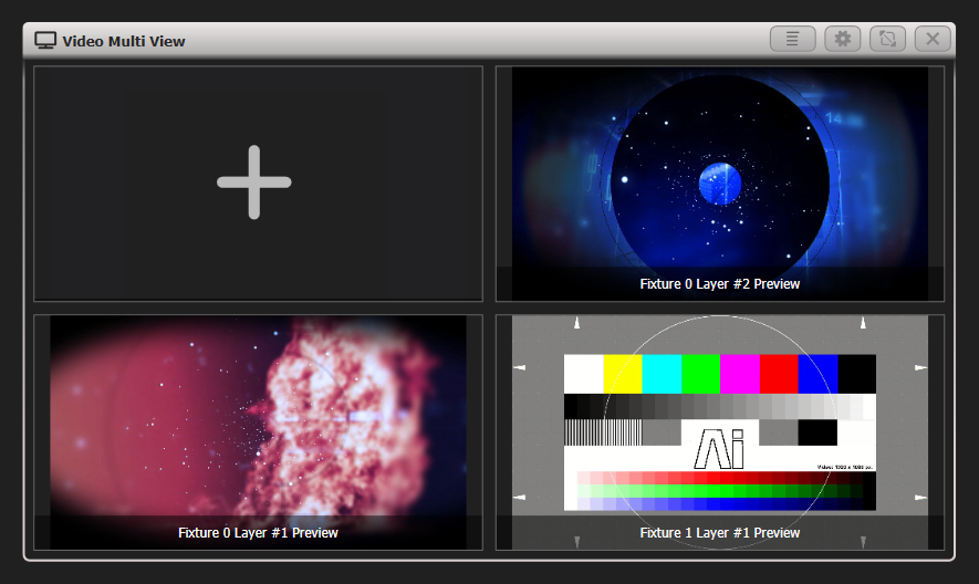

Media Viewer​
The Video Multi View window allows you to view any of the layers being produced by the Synergy layers, or any of the combined surface outputs on an Ai server. In addition you can view any other RTSP video streams available on the network, so for example at a broadcast event the broadcaster could feed you the program output or individual cameras to check lighting levels.
To open this window, double press Open/View and select Video Multi View from the view selection buttons on the screen you want to use.
Video Multi View Window

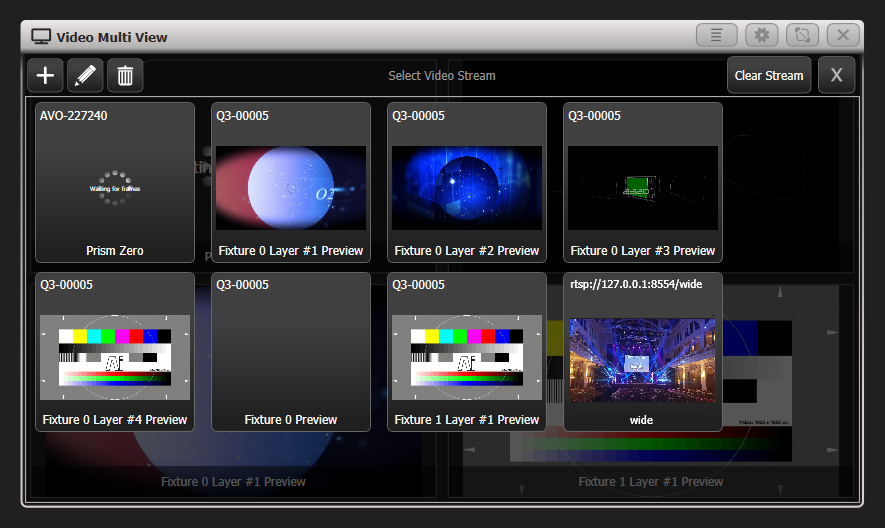

To add or change a stream, click on a view in the window (blank views show a plus symbol). A dialog will pop up showing you available streams, click on the stream to add it to the viewer.
Video Multi View Window adding a stream

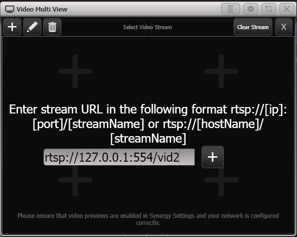

To make a network stream available for viewing, you need to manually add the stream URL. Click the plus button in the top left corner of the dialog and a new dialog will appear which will allow you to enter the RTSP details for the stream you want to view.
  • If you don't enter a port number (:554 in the picture) then port 554 is assumed.
