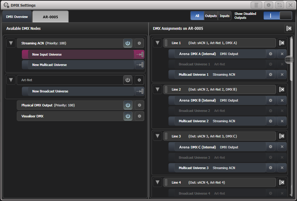

Configuring DMX Outputs​
From the System menu (press Avo + Disk) select DMX Settings.
The window will initially show the node tab relating to the console itself. It shows a list of available DMX nodes (places where you can send the DMX to) on the left, and a list of the available DMX lines (outputs generated by the console) on the right. Each DMX line can send data to one or more nodes. If you assign more than one node to a line, those nodes receive duplicated data. If you have Art-Net nodes or TNP units connected they will show on the left hand side (sACN does not have a discovery system so sACN nodes will not be automatically detected).
On the right hand side, under each DMX line there is a list of which nodes are linked to that line. The default setting on a new show is for the physical DMX outputs on the console to be linked to the first DMX lines.
DMX Settings Window
To assign a node to a line, click on the node on the left hand side (e.g. on New Multicast Universe under Streaming ACN) and then on the line (right hand side) you want this node to be assigned to. The node will appear on the right hand side under the line it is assigned to.
To unassign a node from a DMX line, click on the X button at the right hand side of the node. To delete all nodes from a line, click on the Group delete button (the X button on the DMX line header). To delete all nodes from all lines, click on the X button to the right of the "DMX Assignments" text.
In order to change the assignment, i.e. to assign a node to a different line, you need to delete it from the line it is assigned to (by clicking on the X) first - the node now appears as unassigned on the left hand side - and you can now assign it to a different line.
When patching Art-Net and sACN nodes you can patch a number of universes in one go: select the first node you want to assign (i.e. sACN: Universe 1) on the left hand side enter values for Universe and Quantity with the softkeys, and then click on the line from which on you want to assign this. Titan will then patch the number of universes on consecutive lines.
You can automatically assign Art-Net and sACN universes to the existing output lines by selecting an Art-Net or sACN node on the left, then click Assign All By Line Number. This will assign an Art-Net or sACN universe output with a matching universe number to every vacant line.
Titan will automatically create a new output line when you patch a fixture to a line that doesn't exist yet. You can tell it to assign an Art-Net or sACN universe output to the new line using the Auto Assign option in the Art-Net or sACN node settings (see below).
You can show information about the DMX nodes once they are assigned by clicking the Cog button. For Ethernet/network type nodes, this allows you to set detailed properties such as IP address ranges and net masks. The Cog button on the module in the left side pane sets the properties for all outputs of that type (see next section).
If you have TNPs connected, these can be individually configured using the tabs across the top of the screen.
When transferring shows between different console types, and especially when you have used the simulator, it's a good idea to check the DMX output settings to make sure the settings are what you expected. If you created a new show on the simulator, no physical outputs will be connected.

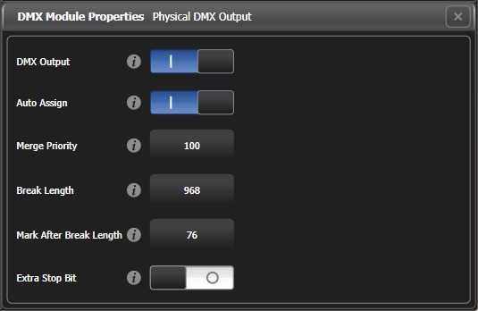

Physical DMX Output Properties​
This changes settings for all the physical 5-pin XLR outputs on the console.
DMX512 Module Properties
DMX output: Allows you to disable all the physical outputs (this is the same as the on/off button in the main Physical DMX Output bar. When outputs are disabled, they are greyed out in the line assignments).
Auto Assign: Sets whether Titan will automatically assign a physical DMX output on a new output line if you patch to a line that doesn't already exist (and unassigned physical outputs are available).
Merge Priority: A value between 0 and 200 where higher numbers have priority, 100 is default. For this DMX output, sets the priority of the DMX from this Titan console over incoming sACN being merged from other sources. You also need to set up DMX Merge using Network DMX Node Settings.
Break Length: Adjusts the DMX spacing which can be helpful for slow fixtures. If fixtures or dimmers show an occasional glitch try increasing this number. Some dimmers will require this to be 4000us in order to work smoothly. Default 968uS.
Mark After Break Length: Usually this will not need to be adjusted, but it can be increased to give fixtures a bit more time to receive the first DMX channel. Default 76uS.
Extra Stop Bit: Enabling this adds an extra Stop Bit to each byte which gives slow fixtures a bit more time to receive the DMX data. This option can sometimes solve issues where fixtures can be seen regularly glitching.

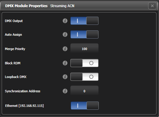

sACN Properties​
This changes settings for all the sACN output from the console.
sACN DMX Module Properties
DMX output: Allows you to disable all sACN output (this is the same as the on/off button in the main Streaming ACN bar. When outputs are disabled, they are greyed out in the line assignments).
Auto Assign: Sets whether Titan will automatically assign sACN output on a new output line if you patch to a line that doesn't already exist.
Merge Priority: A value between 0 and 200 where higher numbers have priority, 100 is default. Sets the sACN priority parameter of this sACN universe being output from Titan. The priority is used on devices receiving multiple sACN streams to determine which data is output.
This is often used to connect a backup console into a system by giving it a lower sACN priority setting than the master.
Block RDM: If enabled, RDM traffic is blocked on this module.
Synchronization Address: If not zero, sets the universe used to synchronise the DMX frames sent from the console. Listening devices will receive all DMX frames and then wait for a packet on the synchronisation universe before using or retransmitting the DMX frames. Synchronous sACN reduces tearing effects which can result from non-synchronised universes. If set to zero, synchronisation is disabled.
Ethernet xxx: Selects which network adapter(s) you want sACN protocol outputting on (multiple adapters may be listed here depending on the setup of your system). If there are multiple adapters in the system you can select more than one, and identical information will be sent out on each one.

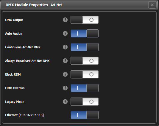

Art-Net Properties​
This changes settings for all the Art-Net output from the console.
Art-Net DMX Module Properties
DMX output: Allows you to disable all Art-Net output (this is the same as the on/off button in the main Art-Net bar. When outputs are disabled, they are greyed out in the line assignments).
Auto Assign: Sets whether Titan will automatically assign Art-Net output on a new output line if you patch to a line that doesn't already exist.
Continuous Art-Net DMX: The Art-Net specification allows the console to only send out changes in the DMX. This setting makes the console send the Art-Net packets continuously even if there is no change.
Always Broadcast Art-Net DMX: Changes unicast Art-Net packets to Broadcast mode, meaning they are sent to all nodes. Unicast packets are addressed to the specific node they are intended for, which reduces network traffic but requires more careful setting up of network addresses (you can still assign Broadcast universes which are sent as Broadcast regardless of this setting).
DMX Overrun: Some Art-Net nodes ignore changes until they are sent more than once. If this option is enabled then at least 3 packets are sent for every change
Legacy Mode: If enabled, Art-Net is broadcast continuously from the console at a high rate. May affect console performance.
Ethernet xxx: Selects which network adapter(s) you want Art-Net protocol outputting on (multiple adapters may be listed here depending on the setup of your system). If there are multiple adapters in the system you can select more than one, and identical information will be sent out on each one.
ArtPoll messages can be disabled via a registry setting. This is occasionally needed for Art-Net fixtures which don't support ArtPoll. If you need to do this or if ArtPoll messages aren't being sent when they should be, contact Avolites Support for instructions on how to change this.

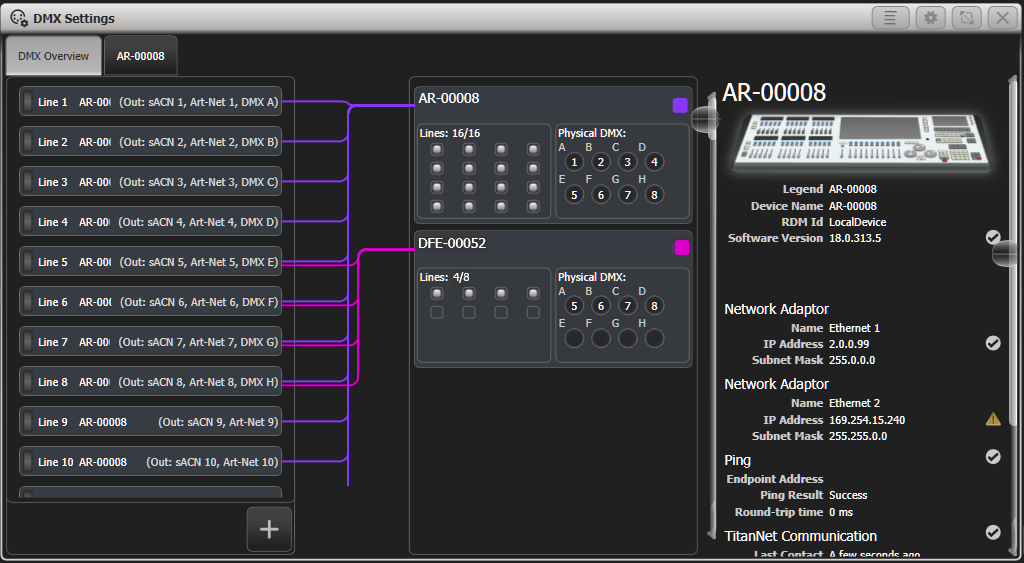

DMX Overview​
If you select the DMX Overview tab at the top of the window, you can see all the TNPs which are connected and which output lines they are allocated to.
DMX Overview in DMX Settings
The left side of the window shows the DMX output lines which are currently setup on the console. To the right of this are the processing nodes which are connected, the top one being the console itself. Each node shows how the lines are allocated to the physical outputs on the device. Clicking this area will open the detail tab for the node.
You can add additional DMX output lines (up to the system limit) by clicking the "plus" button below the list of lines.
Clicking any one of the nodes will show detailed information about that node on the right, including the IP address, number of available processing slots, number of lines assigned, status of the connection with the node, and the processing load of the device. If more lines are assigned than the maximum number of slots, a warning will be displayed.
If a show is loaded that had fixtures and lines assigned to processing nodes which are no longer found on the TitanNet network, a dialog will appear listing nodes in use and available nodes, giving you the option to reassign the lines.
