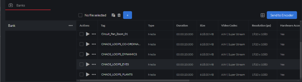

The Banks area can be displayed in two views: Table or Grid.
Table View​
Table View gives more information about video / audio codecs, resolution, whether hardware acceleration is available on the media and much more.
Prism Player Banks

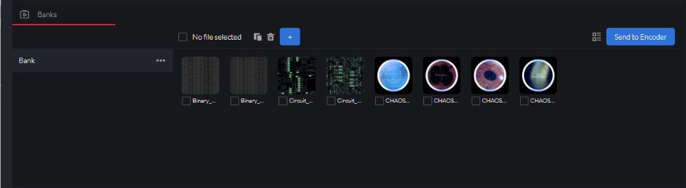

Grid View​
Grid View allows for easier triggering of clips due to the larger trigger area, thumbnails are shown here and are also stored on the Prism Media Cache.
Prism Player Banks
