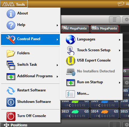

Opening USB Expert Console​
Open the Tools menu from the system toolbar, click on Control Panel and select the USB Expert Console option. For a PC-based device or panel such as T1, T2, T3 or Titan Mobile, run USB Expert Console from the start menu.
Start USB Expert from Tools Menu

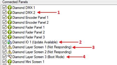

Panel indications in USB Expert​
In the top left hand window Connected Panels, an icon to the left of each panel shows its status.
  • Panels in normal operation show a green USB icon (1).
  • Panels with an update available or which are in Boot Mode awaiting update show a download/clock icon (2). Carry out the update procedure in the next section.
  • Panels which are not responding show a yellow exclamation icon (3). Try performing a panel reset, if this does not help then contact Avolites support.
  • Panels which have been manually put into Boot Mode show a spanner icon (4). If this is not intentional you can select the panel and click Exit Boot on the right.

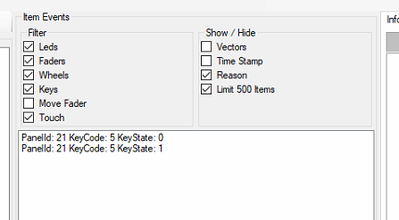

Testing Buttons / switches​
Pressing any button on the panel should show up in the central window as KeyState:0 followed by KeyState:1 when the button is released. If you can see double entries, missed responses or no response at all then the switch may be faulty and should be replaced.

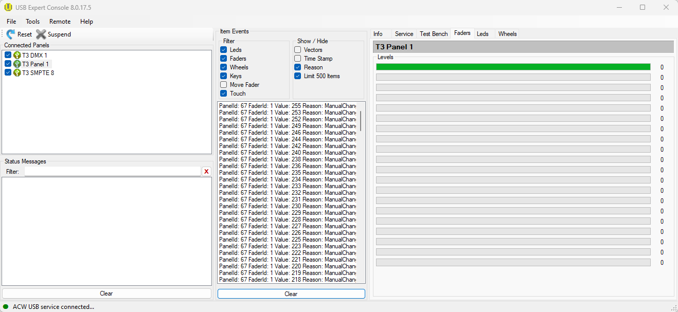

Testing Faders​
In the Connected Panels window on the left, select the fader panel you want to test. On the right hand side click on the Faders tab.
USB Expert Fader Test
  • Slowly raise the fader at a steady, moderate pace. In the central window you should see a value increasing gradually from 0 to 255.
  • The green progress bar on the right should move smoothly upward as the fader is raised. There should be no flickering or erratic movement.
  • The value should not jump back and forth — consistent movement is expected.
  • Once the fader reaches the top, the value should remain stable at 255 without any drops of flickering.
  • Finally, slowly bring the fader back down and check for smooth, consistent behaviour.
If flickering or unstable values are seen, try cleaning the problematic fader with Deoxit F5 Fader Cleaner (alternatives: Servisol Super 10; Kontakt Chemie Cleaner 601). If cleaning the fader does not resolve the problem it may need to be replaced.

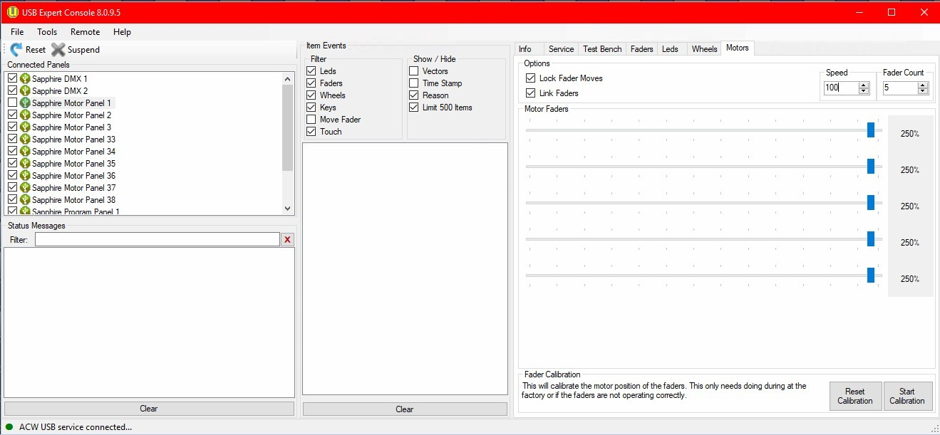

Testing Motorised Faders​
In the Connected Panels window on the left, select the motor fader panel you want to test. On the right hand side click on the Motors tab.
Tick the checkbox for Link Faders and reduce Speed to 30 for testing.
USB Expert Motor Test
  • Move one of the onscreen slider bars to the right.
  • All faders should move smoothly and in unison without any stuttering. If you see any jerky or inconsistent movement it may indicate a fault with the fader's motor - please contact your local Avolites support team.

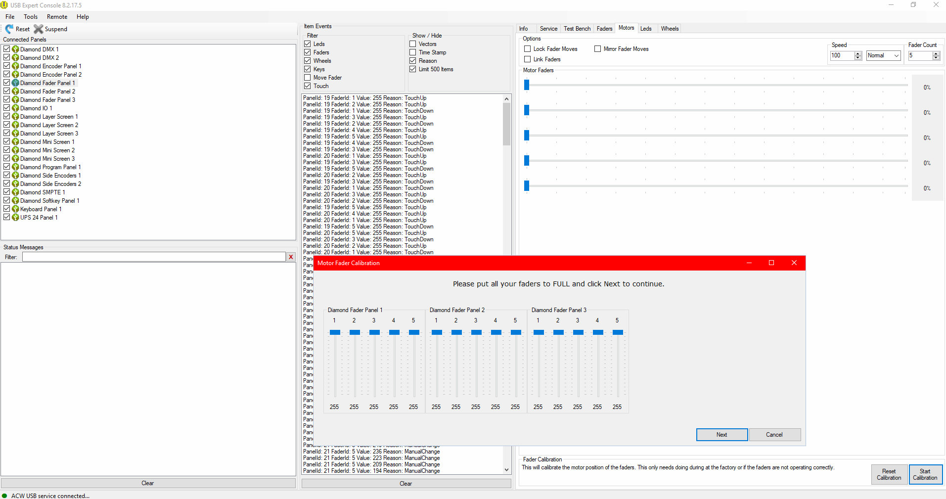

Calibrating Motorised Faders​
If the faders recall to an incorrect position then they may need calibration. In the Connected Panels window on the left, select the motor fader panel you want to test. On the right hand side click on the Motors tab, then press the Start Calibration button on the bottom right of the screen and follow the on-screen prompts.
  • Put all faders on the console to full
  • Put all faders on the console to zero
  • Store the calibration values

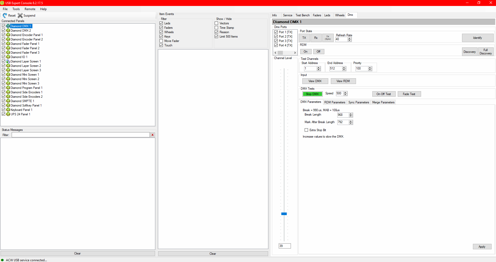

Testing DMX panels​
This test will require a DMX tester. You will need to shut down the Titan software using the shutdown option in the Tools menu.
In the Connected Panels window on the left, select the DMX panel you want to test. On the right hand side click on the DMX tab, then move the Channel Level slider up and down to change the DMX output level. Check with the DMX tester that the correct levels are being output.
  • For consoles with 8 DMX outputs, select DMX 1 to test outputs 1-4 and DMX 2 to test outputs 5-8.
USB Expert DMX Test

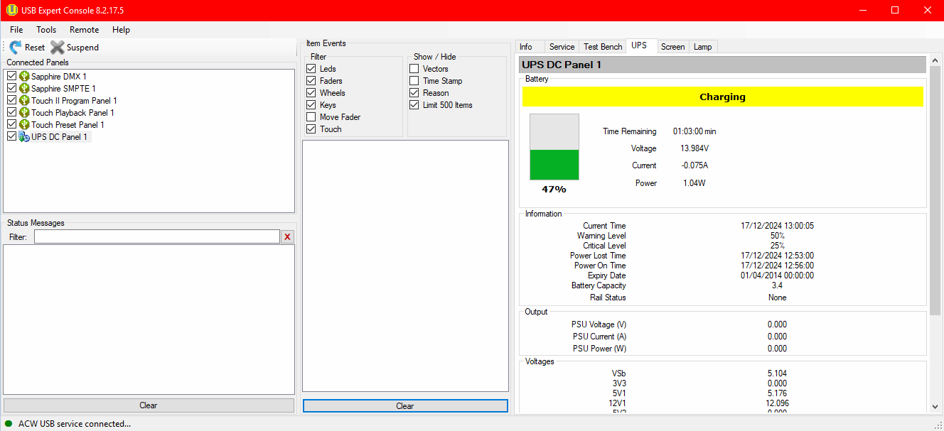

Testing UPS battery​
In the Connected Panels window on the left, select the UPS panel. On the right hand side click on the UPS tab.
  • Make sure that the battery status is set to charging. A fully charged battery will show a current between 0.02A – 0.05A. A charging battery may show a current of 2A-3A.
  • When power is removed the Charging status should switch to a green bar with NoLoad, indicating that the console is on UPS battery.
USB Expert UPS Test

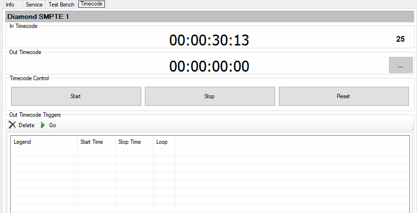

Testing timecode​
In the Connected Panels window on the left, select the SMPTE panel. On the right hand side click on the Timecode tab. Connect a timecode source to the console and you should see the timecode updating in the In Timecode panel.
USB Expert Timecode Test

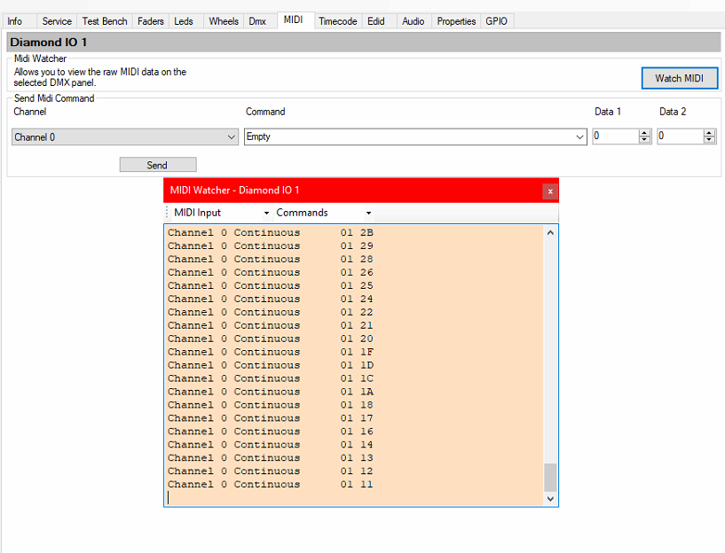

Testing MIDI​
In the Connected Panels window on the left, select the IO panel (or DMX panel on some consoles). On the right hand side click on the MIDI tab and click Watch MIDI. Connect a MIDI device to the console and send some MIDI commands, you should see the commands appear in the MIDI Watcher window.
USB Expert MIDI Test
