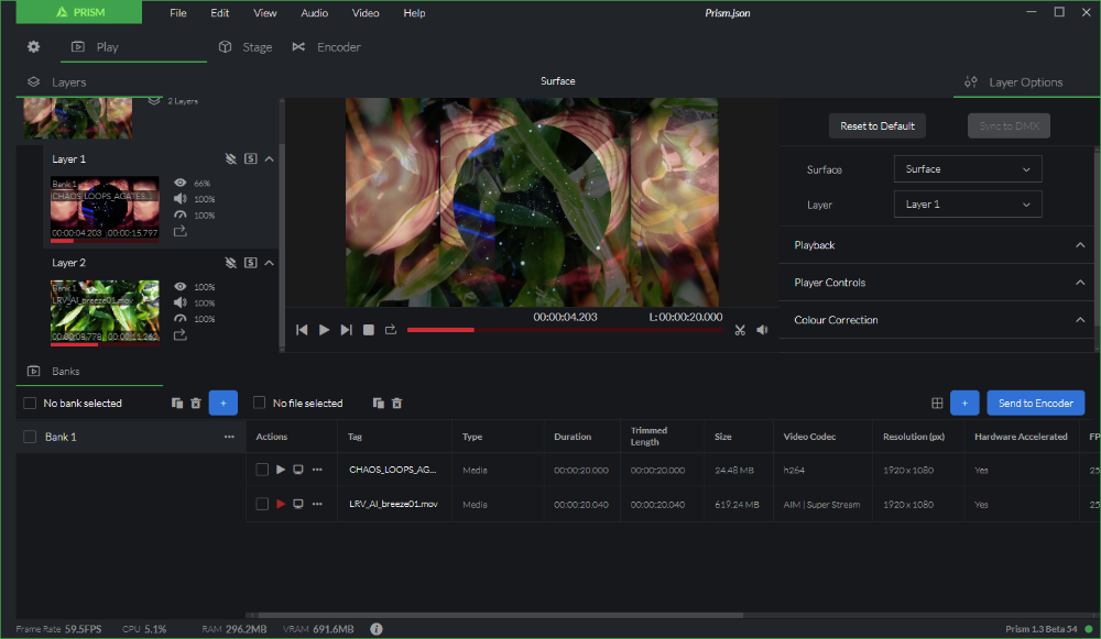

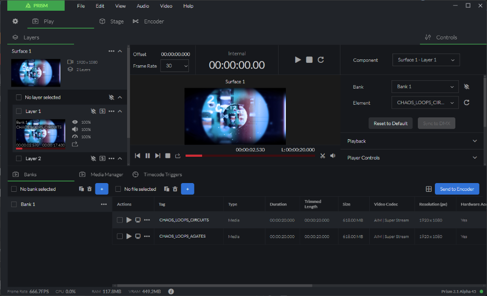

Prism UI
Prism is composed of two parts - the Server and the UI. The Server runs in the system tray and the UI will run separately and show the interface.
Please note that closing the UI doesn't necessarily close the server as this allows for any playback, encoding, or Synergy control, to carry on behind the scenes. More information on this is found on the General settings page.
The Server and the UI communicate using port 9030, no other application must use this port in order for Prism to work.
When starting Prism you may be prompted to add a firewall exception. If you have this experience please add this port to your firewall / anti-virus lists.
