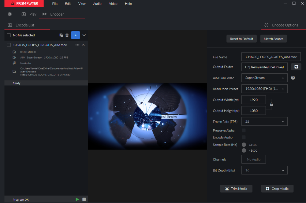

The Encoder allows for files to be converted from common video codecs into the AiM codec in preparation for use on a live production.
Encoder
Encode Element​
When a piece of media is loaded into the Encoder, several details about the file can be viewed:
Encodelist Details
  • The length of of the encoded media.
  • The video codec, sub-codec, resolution and frame rate of the encoded media.
  • The audio codec, bit depth, sample rate and channels of the encoded media.
  • The destination folder of the encoded media.
  • The current status of the job - Ready, In Progress or Done.

The order in which the elements are arranged will be the order of the encoding queue this can be changed by dragging and dropping the element to another position in the queue.
At the bottom of the Encoder queue a readout shows the completion percentage of the total jobs.
Next to this are the Play / Pause and Stop buttons which control the encoding process.
